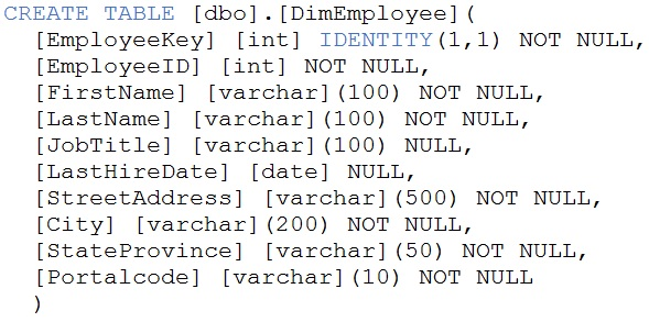

You have a table in an Azure Synapse Analytics dedicated SQL pool. The table was created by using the following Transact-SQL statement.
You need to alter the table to meet the following requirements:
✑ Ensure that users can identify the current manager of employees.
✑ Support creating an employee reporting hierarchy for your entire company.
✑ Provide fast lookup of the managers' attributes such as name and job title.
Which column should you add to the table?
[ManagerEmployeeID] [smallint] NULL
[ManagerEmployeeKey] [smallint] NULL
[ManagerEmployeeKey] [int] NULL
[ManagerName] varchar NULL

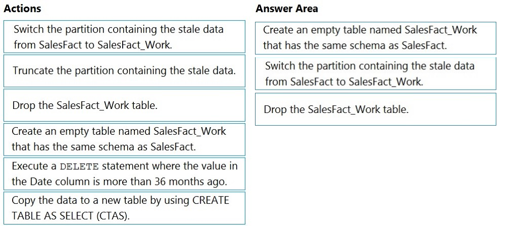

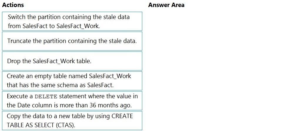

You have a table named SalesFact in an enterprise data warehouse in Azure Synapse Analytics. SalesFact contains sales data from the past 36 months and has the following characteristics:
✑ Is partitioned by month
✑ Contains one billion rows
✑ Has clustered columnstore index
At the beginning of each month, you need to remove data from SalesFact that is older than 36 months as quickly as possible.
Which three actions should you perform in sequence in a stored procedure? To answer, move the appropriate actions from the list of actions to the answer area and arrange them in the correct order.

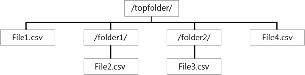

You have files and folders in Azure Data Lake Storage Gen2 for an Azure Synapse workspace as shown in the following exhibit.
You create an external table named ExtTable that has LOCATION='/topfolder/'.
When you query ExtTable by using an Azure Synapse Analytics serverless SQL pool, which files are returned?
File2.csv and File3.csv only
File1.csv and File4.csv only
File1.csv, File2.csv, File3.csv, and File4.csv
File1.csv only

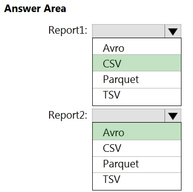

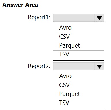

You are planning the deployment of Azure Data Lake Storage Gen2.
You have the following two reports that will access the data lake:
✑ Report1: Reads three columns from a file that contains 50 columns.
✑ Report2: Queries a single record based on a timestamp.
You need to recommend in which format to store the data in the data lake to support the reports. The solution must minimize read times.
What should you recommend for each report? To answer, select the appropriate options in the answer area.
